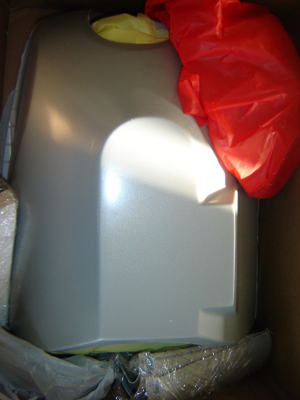

Armor came in today!
I'll be tracking my build here, and at other sites. As always, feedback, comments and ideas are welcome. I'll be building a tutorial for how to build this as I do it, so future snow clones can have a manual to work from. On to the armor:

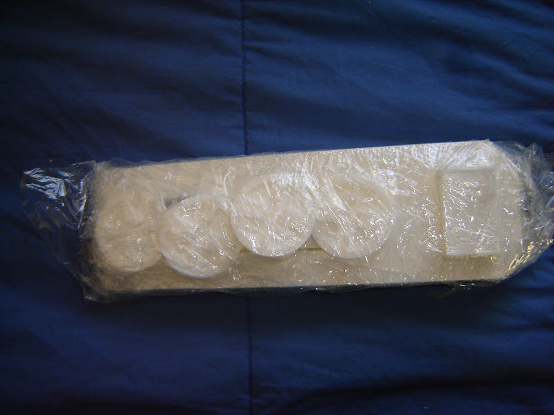

Well packed and preserved:
Resin details:

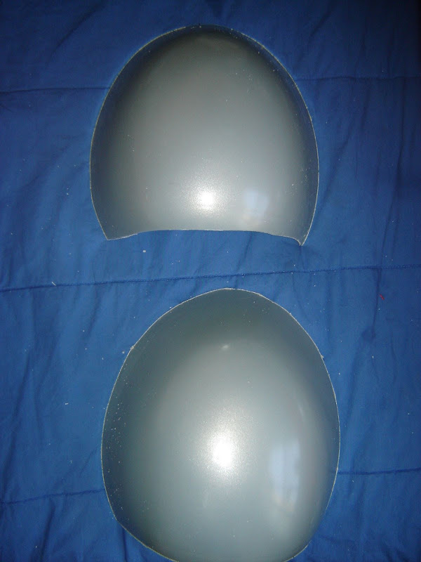

Shoulder bells:

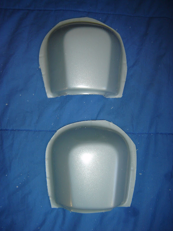

Knees:

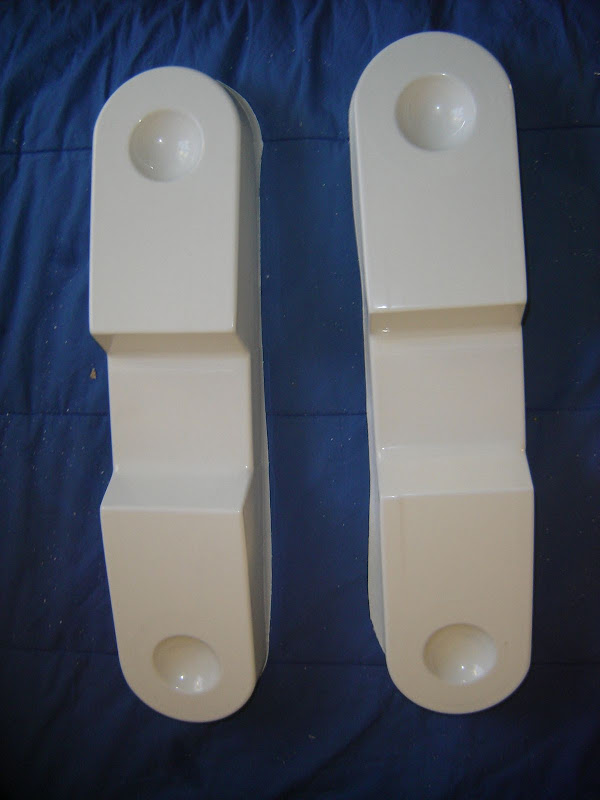

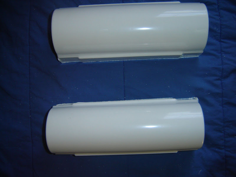

Handplates:

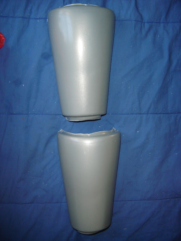

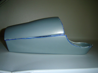

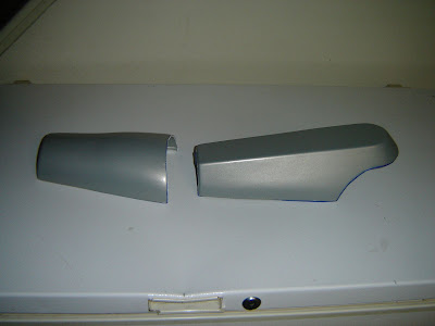

Arm part inside:
Arm part outside:

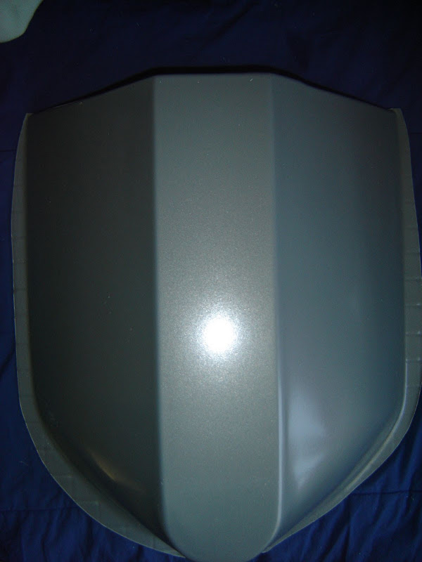

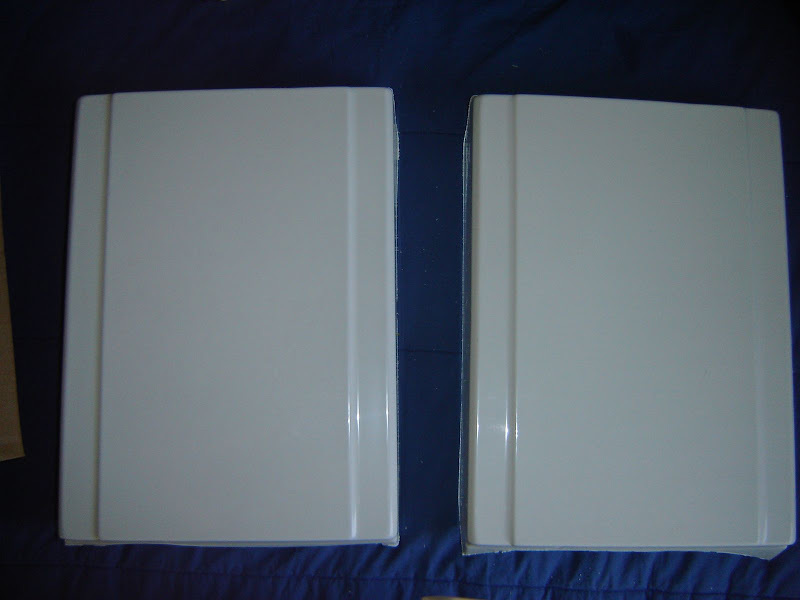

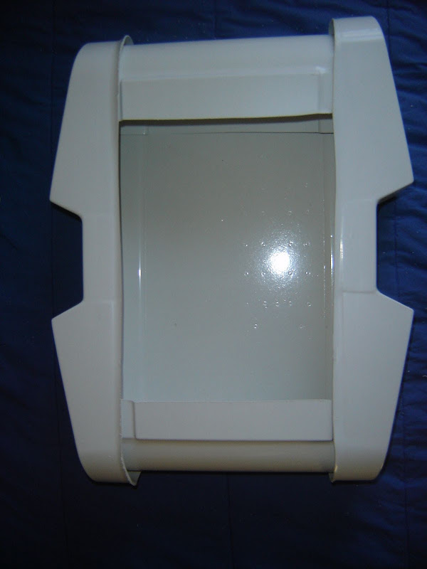

Backpack parts:
Cod/ab:
Extra plastic shims:

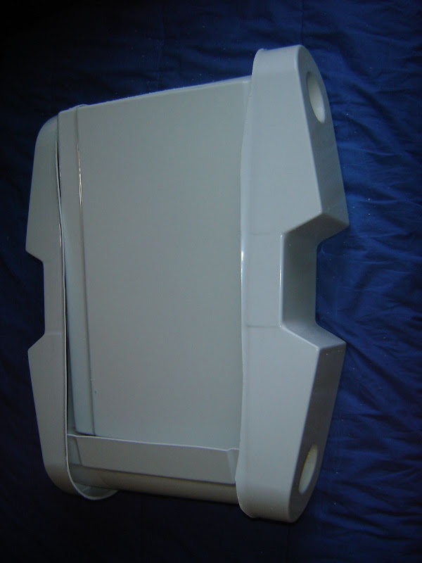

Backpack rough fit:
Thoughts:

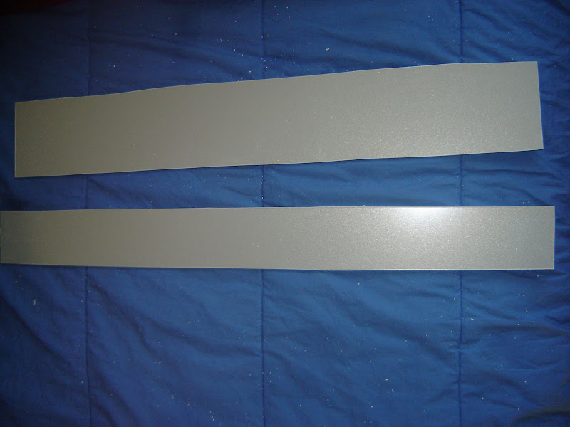

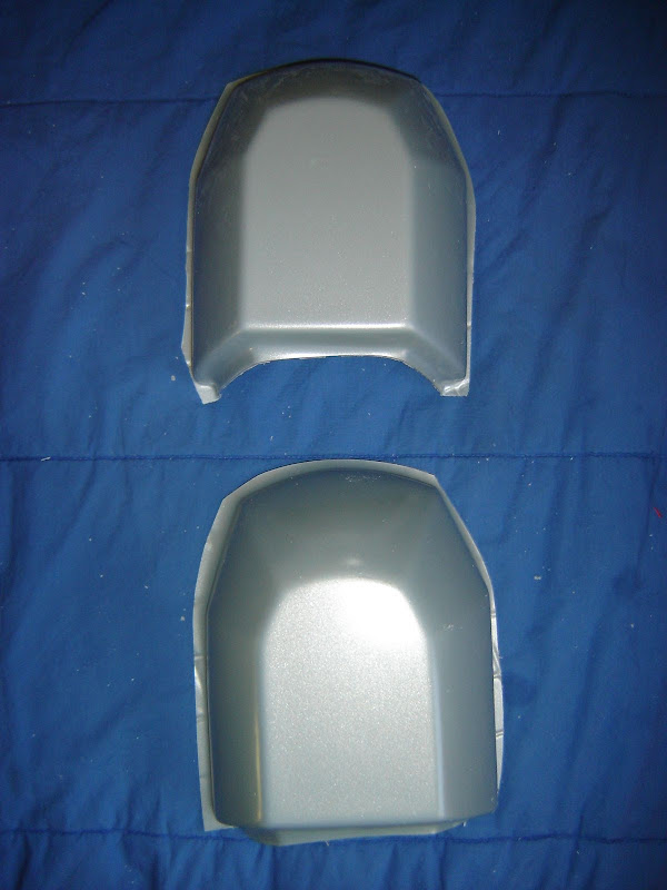

Pulls look good, and it was well packaged. I'll look at it more tomorrow and compare to the pics, but it feels and looks right on initial glance. For accuracy's sake, we'll probably need a back plate for it, but in the mean time, I have enough to keep me busy for a bit. If nothing else, I am considering looking at Mando/Fett ones, or some other pre-made backplate kit.
I also kinda like having the backpack in separate pieces, because it give me the possibility of adding moving doors and hidden hinges for storage. Camelback hydration bladders would fit in here nicely.
I will need to get belt boxes. I'm considering getting vaccuformed ones, as this will allow me to hinge those and allow for hotel and car key storage, and for carrying business or trading cards. After having worn the snowtrooper as much as I have, I really, really appreciate having the pouches on the dusters. So either hinged belt boxes or sewn in pockets on the kama are going to be a necessity for quality trooping. It might not sound like much, but IMHO, easy access to a hotel room key or a business card is a huge bonus.
I'm very happy with the look, fit and scale of it all. It has some trim lines and should be a fun build. Let the fun begin!!!

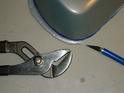

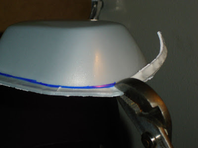

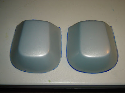

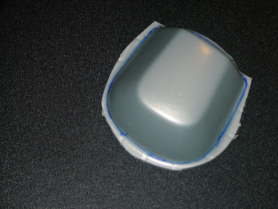

I made some progress last night. Nothing special, just trimming. basic score & snap. For those of you who have done this on other projects, the next part is pretty boring. I'm writing this for those who haven't done this before, so please forgive this step and just skim through the pictures:
First thing I do is go over the trim lines with a permanent marker. This kit's trim lines were easy to see, but I prefer to hit them with a dark marker anyways, to give me a solid aim point. I did this for all of the pieces.
If you want really clean lines, I recommend using racheting hand clamps --not spring clamps!, and a heavy duty metal straightedge. The racheting clamps let you secure the straightedge very well --far more than a spring clamp will, IMHO.
One thing I left in the pieces so far are the "returns", or the curved part that come towards the skin. It gives the impression that the armor is thick and solid. As I get to the fitting stage, I'll grind away at these, but try to leave some of it in places if I can.
Score and snap:
Here is how simple it is: Take a utility knife or X-acto knife blade and cut along the cut line lightly. You are "scoring" the plastic, not trying to hack your way through it. Make firm, but fairly light scratches along the lines.
Take your time.
Take your time.
Take your time.
I emphasize this, because I can get eager to make progress, and rush things some times. I'm not one of the uber-anal perfectionist types (I do love you guys though!) so I have to force myself to slow down and not try to "knock out one more piece" before I go to bed. If you slip with the knife, you can make a cut line go bad, ruin a piece of armor, or cut yourself. You decide which is worse. Wink
When I'm at this stage of the build, I prefer to listen to a book on tape (or CD), or play a movie in the background... something to keep the brain engaged and keep me from rushing too much. The audiobook for the build is Starship Troopers. I've read the book a hundred times, so it makes great background noise as I score and try to keep from sticking myself.

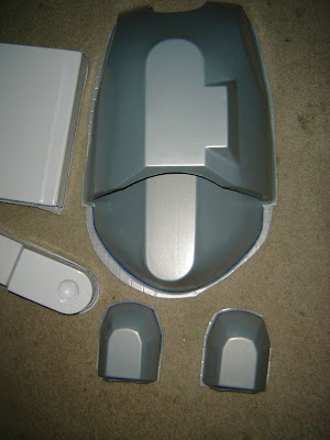

Once you get a good amount of scoring done, cut a break line to the edge, to give the plastic a logical fail point when you take the pliers to it. Just grab, and work it back and forth. Feel free to score some more, to ensure a good cut line when it finally snaps off.
I intend on putting the pieces on a belt sander or grinder later to clean up the edges, so it's not the end of the world if the edges are a smidge rough.
And here we go, one piece down:

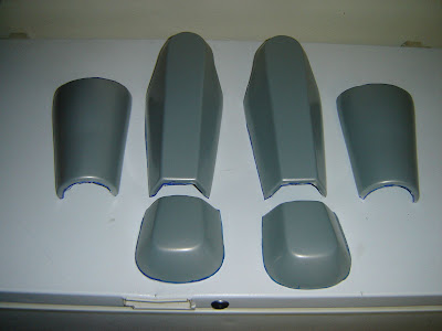

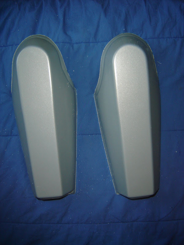

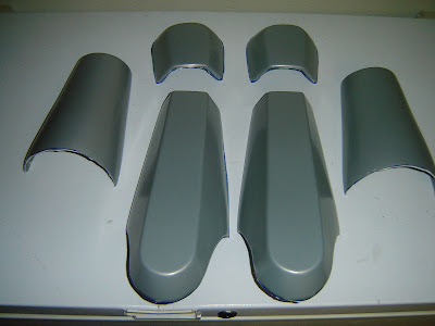

And a couple of hours later, I have the hand plates and forearms done:
I'll clean up the edges later. In time, the edges will be clean, and fitted, just like my snowtrooper:
Next step:
Finishing the rough trimming of the parts, and cleaning some edges for fitting together.
